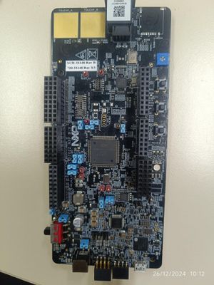

Can you identify the exact type of board, I'm confused about this
MCU: P32K344EHVPBS0P55A

Hi@Voledi
According to the information in the picture, the transceiver here should be TJA1153, so there is no problem if you refer to this link, but this is based on S32 DS V3.4 + RTD 2.0.0.
https://community.nxp.com/t5/S32K-Knowledge-Base/Example-S32K344-FlexCAN-Ip-TX-RX-EnhanceRXFIFO-test...
