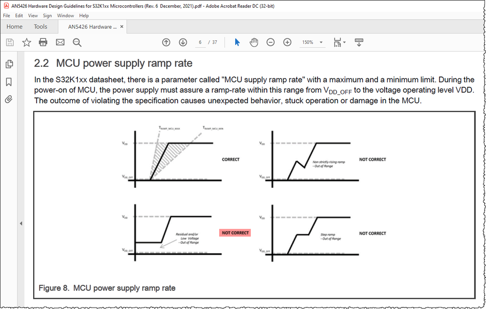

We are working on S32K148 micro. As per the data sheet we see the POR will be detected when Vcc is <1.6V . Is there any problem if the Vcc is not dropping to 0V before we power on the micro with 3.3V Vcc, to detect a valid POR? Is there any rise time and fall time requirements for detecting power down and power on reset? Is there any specific application note available that details the procedure during the power down and power on reset of the micro? I could find only the details on specific operation power modes , but not the details on the power down and power on reset operation of the micro.

Robin_Shen
Please refer to the "2.2 MCU power supply ramp rate" of AN5426: Hardware Design Guidelines for S32K1xx – Application Note
Robin

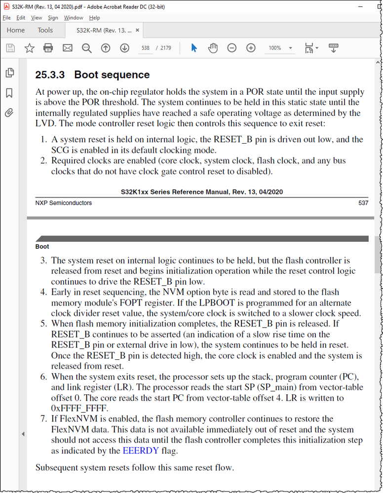

Also , any details on the power down and power on reset procedure internal to the micro boot up?
2,641件の閲覧回数
Robin_Shen
Max VDD_OFF=0.1V so 0.5V is still violate the specification.
As the AN5426 mentioned: The outcome of violating the specification causes unexpected behavior, stuck operation or damage in the MCU.
