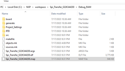

Hi SivaB,
Memory's information that you can check in the .map file. For example:
