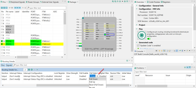

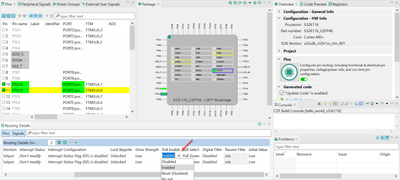

Hello, about how to enable the pull-up and pull-down of the Port port in the S32K14x series software
799 Views
Julián_AragónM
Hi @chuanlin,
You can change the configuration for the pins inside the Pins view for Config Tools:
This changes the g_pin_mux_InitConfigArr0 array, which is used inside the PINS_Init function:
