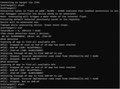

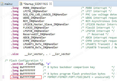

1、I Change the configuration parameter to BF;
2、Compile and download firmware to the EVB board;

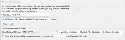

3、Now ,"Device is secure, Erase to unsecure?" is displayed when the OpenSDA interface is used to debug a connection. However, after you click yes, the erasure operation cannot be performed and the OpenSDA interface connection is abnormal
I tried to send unlock kinetis to unlock using the jtag interface connection, indicating that the unlock was successful, but in fact it did not, the following message was displayed when jtag connected.
May I ask you how to solve this situation?
How can I unlock it?
Thank you all!

duke_run_run
Thank you for your reply!
I tried to erase it by writing the DMD-AP control register, but it didn't seem to work;
The operation is recorded as follows:

My EVB board is connected normally, reset is not grounded, jlink attempt to unlock will fail, but the command can be executed normally, but actually did not erase successfully, the board still cannot be used normally;
How do I enable mass erase next? Or through a backdoor and what is the back door interface?
thanks!

Thank you very much for your reply!
I read the application note you said, and I determined that the value of FSEC is 0xBF, so the bit corresponding to MEEN is 0b11, so mass erase should be enabled, MDM-AP Status reg is 0x74, I don't understand why I can't really erase when I write 1 to bit0 of MDM-AP Control reg?
