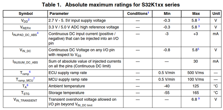

Does the S32K148 series of chips integrate clamp diodes inside each GPIO pin?

Hi @1396617186,
Yes, each pin is clamped to both VDD and VSS.
The max. injection current is +-3mA per pin.
