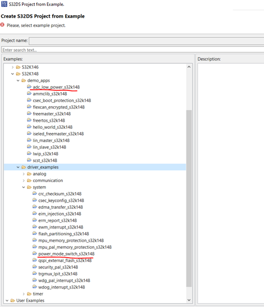

Senlent
Hi@qianqin_wang
You can find the following routines in our S32 DS
The following link is a Chinese document and tutorial, you can refer to learn about the low power consumption of S32K1
https://mp.weixin.qq.com/s?__biz=MzI0MDk0ODcxMw==&mid=2247485647&idx=1&sn=2738a55639240dc837d9320116...

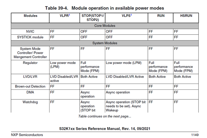

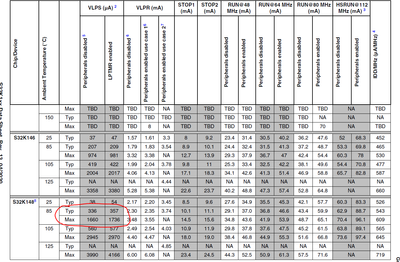

qiaoqin_wang
Hi Senlent
thanks for your reply , i also want to check why at the same temperature,the current is different.
for example: the S32K148 the typ ad max value is different at the same temperature,what the reason that makes the current is different?
1,472 Views

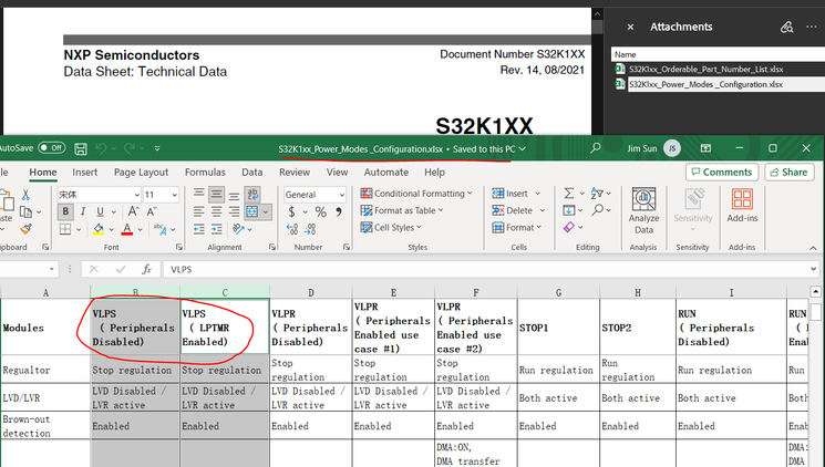

Senlent
Hi@qiaoqin_wang
Because the test conditions are inconsistent,
You can see from the title that although they all work in VLPS mode, some peripherals are turned on or off.
You can find the details in the appendix of the data sheet.

Senlent
Hi@qiaoqin_wang
Please try to use this tool to see the power consumption.
https://www.nxp.com/design/design-center/software/automotive-software-and-tools/s32k-power-estimatio...
Or you can check our datasheet.
