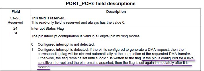

And even if it was stuck in an ISR, does it mean you cannot clear the corresponding flag?
Is the port configured for a level sensitive interrupt or an edge sensitive interrupt?
   ->level sensitive

Is it possible that sometimes the PORTE input signal remains asserted?

In wakeup source ISR, software reset is performed so it doesn't matter even the pin remains asserted.
