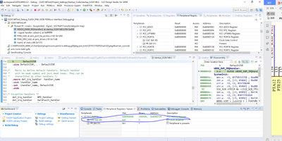

hello, I am confused,
when I use the SDK RTM3.0.0, the board will defaultISR when getting the PIN_DRVS_Init(),as followed; but there is no problem without SDK,
all the programs are attached, please help me, Thank you!

BusFault: A precise (synchronous) data access error has occurred.
Possible BusFault location: 0x40049000.
HardFault: A fault has been escalated to a hard fault.

Have you check the clockMan1.c, did Processor Expert set clkGate=true for PORTA?
If still not work, then please update SDK S32K1xx RTM 3.0.3 by refer: S32 Design Studio for ARM 2.2 - Update 1 available

I can see you configure PTA0 as output. If you click Generate Processor Expert Code, then you should see the clkGate=true in clockMan1.c.
The clock gate of PORT A should be initialize by Processor Expert, do not need enabled by yourself.

wdong
but mine is 0x0, oh no!

wdong
I already update the SDK. and I checked that, clkGate = true in clockMan1.c, but the registers value is still 0x0, I am confused.
Please help me.
