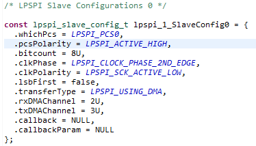

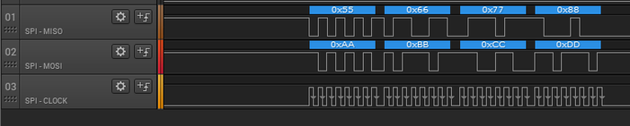

danielmartynek
Hello @SONGTAOSI,
I'm sorry for the delay.
Please find the test project attached (S32DS 3.4, SDK RTM 4.0.3)
The slave receives 4 8bit frames in the AUTOPCS mode (1MHz).
