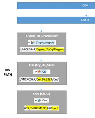

Hi TeamNXP,
We need help regarding configuring 'SHE KEY GENERATION i.e. M1 to M5 using CSM HW stack for S32K148 MCU.
We are already aware of c project examples from NXP.
But we are looking for any references or examples on how to get the same done (Generation of M1 till M5 and SHE Key programming) using CSM, Crypto_Wrapper, Cry_If, Cry (HW)
Looking forward for your response. Thanks in advance.
S32K148EVB S32K148-T-BOX
1,602件の閲覧回数
lukaszadrapa
Hi @KanthReddy
Our RTD package contains Crypto module. There are only stubs for Csm or CryIf. If you require examples for Csm or CryIf, ask provider of these modules (Vector?).
Crypto in RTD contains examples how to calculate M-M5:
c:\NXP\S32DS.3.5\S32DS\software\PlatformSDK_S32K1_S32M24\RTD\Crypto_TS_T40D2M20I0R0\examples\S32DS\S32K1\Crypto_AesEncDec_S32K148\
