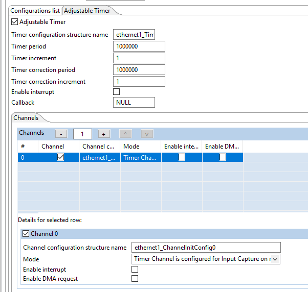

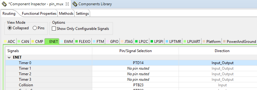

veronicavelciu
Hello Jakub,
I recommend using S32 Design Studio for ARM together with the S32 SDK. You can start from the enet_loopback example and you will be able to configure the pins and the ENET timer through the graphical interface. In order to enable the timer channel, you will need to add the following code sequence:
ENET_DRV_TimerInit(INST_ETHERNET1, &ethernet1_TimerInitConfig);
ENET_DRV_TimerEnableChannel(INST_ETHERNET1, 0U, &ethernet1_ChannelInitConfig0);
ENET_DRV_TimerStart(INST_ETHERNET1);
You should be able to use the Timer 0 channel on the S32K148 evaluation board.
