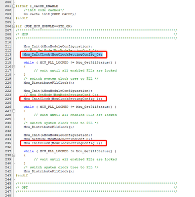

ananan
why init three clocks?

hungnguyenphi
Hello @ananan ,
I have check your configuration and I can create a simple project(with your configuration and also the MCAL version 4.3 RTM 1.0.1) and run normally with this configuration. I just send it to your email.
For your question why we need three clock init, the answer is  because this example use 4.2 RTM 1.0.3 version(Please see the https://community.nxp.com/t5/S32K/MCU-Setting-issue-on-S32K14X-MCAL4-2-RTM-1-0-4-about-quot-Clock/td... for more information).

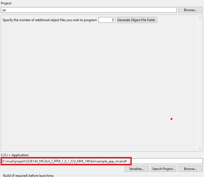

thank you very much ! but how to open you project with s32DS ? I want to download to my mcu.
2,090 Views
hungnguyenphi
This project is not created from S32DS so you cannot add it to S32DS. This project can be compile with make file.
- If you want to compile please update the paths in the file launch.bat then run the
    + "launch.bat TOOLCHAIN=iar" (for IAR compiler)
    + "launch.bat TOOLCHAIN=ghs" (for GreenHill compiler)
    + "launch.bat TOOLCHAIN=linaro" (for GCC compiler)
Anyway, we still can debut this project with S32DS by loading the ELF file. Please see below picture for more information.
