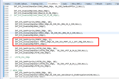

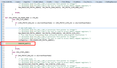

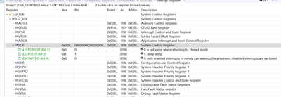

At present, s32K148 enters VLPS mode from RUN mode, and the test circuit board current changes from 120mA to 9mA. It feels that the circuit board has entered VLPS mode, and the WFI command is executed. During the simulation, the following WFI command is not executed.
Then, I configured the Icu module and added the wake source and Sleep mode of Icu and EcuM in davinci Config software. The INTERRUPTION of THE Icu was working, but the Icu pin was triggered externally after Sleep, but the test current did not respond

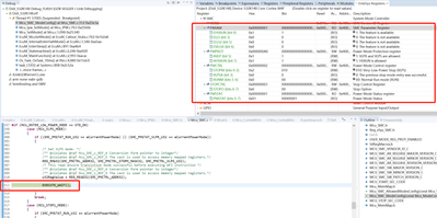

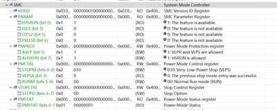

The following figure shows the register values when entering VLPSananan_1-1637725260830.png
Now I don't know how to wake up MCU. I hope experienced experts can help me!

Hello @ananan ,
Could you please check if Icu pin was triggered externally after Sleep, then is the ICU interrupt handler  called.
Hung

ananan
In VLPS mode, THE Icu interrupt cannot be triggered because I called serial port print in the Icu callback function, but in RUN mode, the Icu interrupt is working and when the Icu interrupt is triggered, the callback function can be called

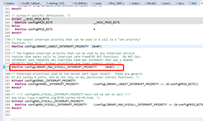

I used freertos system, icu priority is 2, freertos boundary function priority is 7, as shown in the picture below, is you said "the value of BASEPRI in VLPS mode" is the freertos boundary function priority?

hungnguyenphi
Hello @ananan ,
Could you please run to the WFI then check the basepri(above picture) value
Hung

ananan
the basepri value is above picture.

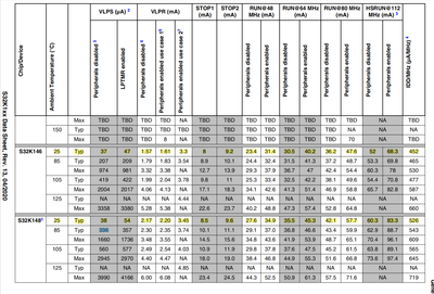

I tested the current of MCU is 8.3mA, and the supply voltage of MCU is 3.3V. I felt that MCU did not enter VLPS mode, but the MCU entered sleep mode according to the value of the register. How to explain this phenomenon?

Does you mean that the current is so high. If yes, we can reduce the current by disable all unused peripherals.

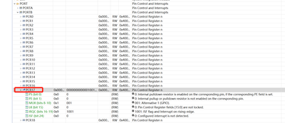

hungnguyenphi
Hello @ananan ,
Thank you for your information. Could you please share these below information(when the MCU is in VLPS mode):
- The pin which you are using for wake up.
- Value of  PORT_PCR(of the wakeup pin) register.
- Value of NVICISER0, NVICISER1, NVICISER2, NVICISER3
- Push the wakeup pin in the VLPS mode and check the value of NVICISPR0, NVICISPR1, NVICISPR2, NVICISPR3

ananan

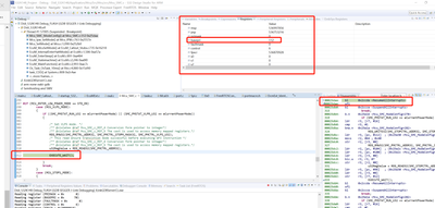

The program executes to the breakpoint shown below
ask:PTB17
ask:

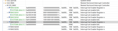

ask:
ask;
After WFI execution, S32DS simulation program cannot be used, so when wakeup pin is triggered, the value of NVICISPR0, NVICISPR1, NVICISPR2, NVICISPR3 cannot be checked. The value in the figure above is the value at the breakpoint in Figure 1
6,849 Views
hungnguyenphi
Hello @ananan ,
Thank you for your information, these information seem doesn't make sense to me because it look like the interrupt handler has been serviced. Because if the Wakeup pin has been pushed, the flag ISF of PCR17 should be set(It just be cleared by ICU_PORT_CI_B_EXT_IRQ_ISR interrupt handler but you said that the ICU_PORT_CI_B_EXT_IRQ_ISR was not called).
Could you please go into VLPS mode then push a break point in the ICU_PORT_CI_B_EXT_IRQ_ISR  and check if the ICU_PORT_CI_B_EXT_IRQ_ISR  is called after the wakeup pin(PTB17 is pushed and released). If not, at least we can see the flag ISF of PORTB_PCR17 is set and also the pending interrupt of the PORTB in the NVICISPR1.

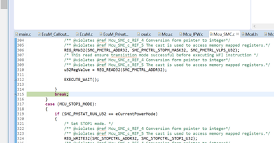

ananan
I have just found a new phenomenon, when my program is executed to the position above, when I step over debugging, the program can still execute the code down, indicating that THE MCU still does not sleep, whether the reason why it cannot wake up is because there is no sleep. But the register configuration at this breakpoint is all right. Why is that
6,826 Views
hungnguyenphi
Hello @ananan
Could you please just set a breakpoint right behind the EXECUTE_WAIT() and then run(click to play button) and check if the program can hit this breakpoint.
- If yes, the program cannot go into VLPS mode.
- If not, the program is already in the VLPS mode. After that if you hit the pause button, it will be count as a wakeup signal in VLPS mode and the MCU will wakeup. Then you will be able to step over debugging.
Hung
6,822 Views
ananan
yes,
 if this what can I do?
