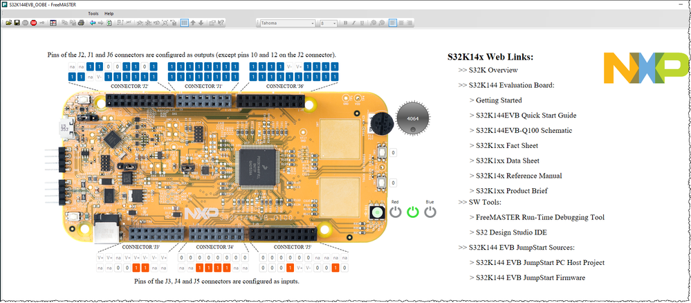

               Step 2: Jumpstart based on the FreeMASTER tool
My problem appears here.
When I try to setup the communication (p°14 of the pdf), I cannot choose the port "opensda", I can only choose COM3 or COM_ALL. If I select one of them nothing changes.

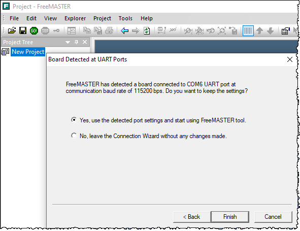

I try to use the tool Connection Wizard and I have the same problem. I can only choose "COM3 - OpenSDA - CDC Serial Port". When I select it, I have the error "No board detected on any specified UART communication ports" (I try with all values of the baud-rates).

Please download the attached S32K146EVB_OOBE_FreeMASTER_Firmware.srec
Then you should be able to connect the board with FreeMASTER.

thomas_leborgne
It works properly
Thank you
