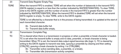

saireddy_saredd
Hi @VaneB
I also see strange behavior with controller.
1. The Status register showing setting Flags TC and TDRE.
2. IRQ handler calling LPUART_DRV_TxCompleteIrqHandler(instance);
3. But the transfer not Finished and see lpuartState->txSize not eual to 0 (It has value 18= 0x12)
4. The controller hanging and keep on calling the LPUART_DRV_TxEmptyIrqHandler
Attached screenshots for your reference.
Does the LPUART_DRV_SendDataBlocking function has any issues?
Why the controller generating interrupt without finishing the actual transmission?
How can I fix this issue?
Sai
