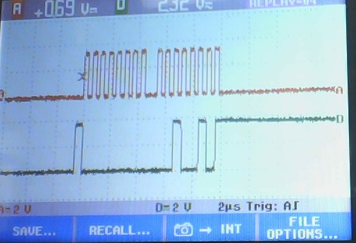

Hello all,
I'm using S32K146 and trying to receive data while communicating with the slave.
But, there is a difference in what actually on the scope & what I receiving the data?
Initialization as follows.

My function includes transmitting 16 bits in 2 frames 8 bytes each with continuous transfer
int8_t master_slave_communication( address)
         while((LPSPI0->SR & LPSPI_SR_TDF_MASK)>>LPSPI_SR_TDF_SHIFT==0) {} \
         LPSPI0->TDR = LPSPI_TDR_DATA(n)
         while((LPSPI0->SR & LPSPI_SR_RDF_MASK)>>LPSPI_SR_RDF_SHIFT==0);
         ret= LPSPI0->RDR;
         ret= LPSPI0->RDR;
         LPSPI0->TCR &= ~(LPSPI_TCR_CONTC_MASK) ;
The Image on the scope which shows Clock and MISO signals
But the data I received is 0x5B.
Kindly suggest me where I went wrong,
Raju

In fact, I found a mistake with CPHA. Now I'm able to see the results as expected.
Raju
