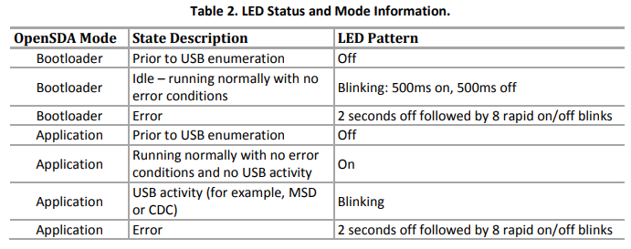

From yesterday, it gives OpenSDA LED error indication, without any reason (When I drag & drop *.bin file) . It pauses for 2 Sec, and blinks 8 times  and pauses again for 2 sec. According to Open SDS LED error code, this seems to be an OpenSDA Application Error.
When I press the reset button and go to bootloader mode, everything seems alright. It mounts BOOTLOADER and I can drag and drop 'BOOTUPDATEAPP_Pemicro_v111.SDA' and 'MSD-DEBUG-S32K146EVB-Q144_Pemicro_v121.SDA'
So I believe the OpenSDA application is good

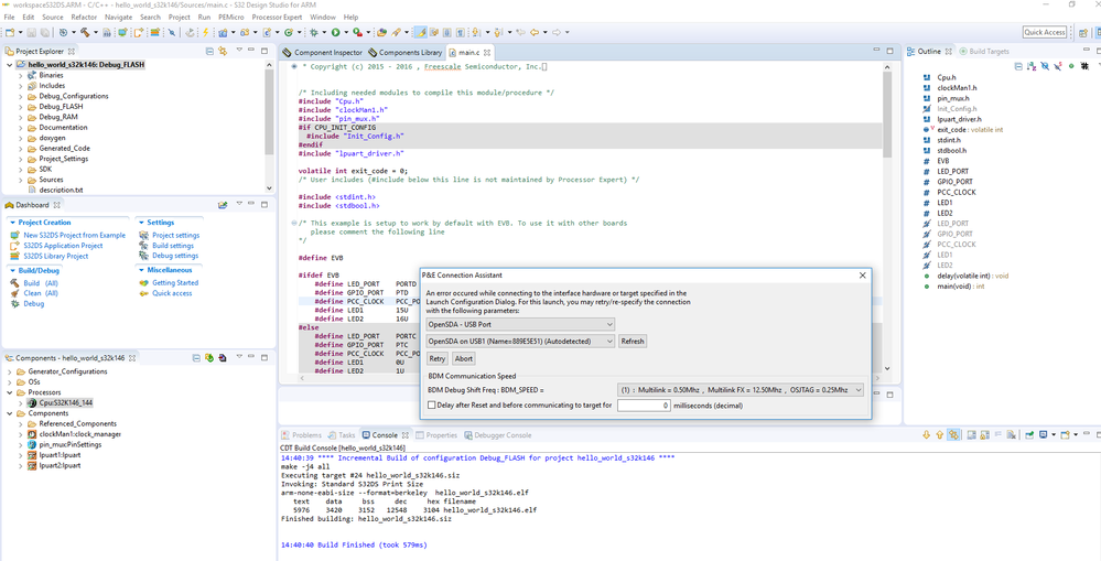

While trying flashing a S32 DS provided application (which was working earlier) using the 'flash' symbol from the IDE, It gives me a P&E connection assistant error telling that it cannot connect to the interface hardware. Please see the image attached.

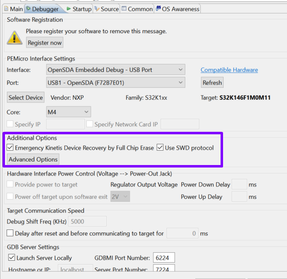

You can try the Emergency Kinetis Device Recovery option.

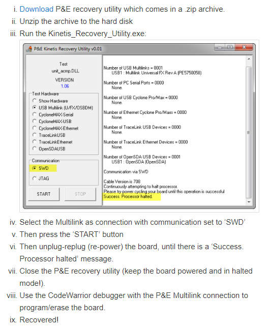

Or use the PE recovery utility as described in this article:
Bricking and Recovering FRDM-KL25Z Boards: Reset, SWD Clock and Low Power | MCU on Eclipse
This utility can halt the execution just after power-on-reset.
And if successfully halted, maybe it can be reprogrammed.

I tried option 1 : Emergency Kinetis Device Recovery option, but it could not flash it and gave me P&E Connection assistant error as shown in my previous message on May 12.
Option 2 : It seems that I need to have 'PEmicro’s USB Multilink ' and I do not have one.

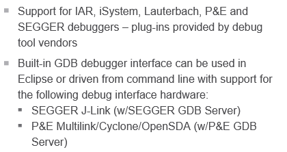

If we need to buy a JTAG programmer, can you suggest which works best for both OpenSDA Chip on my board (K20 I assume) and S32K146. From PE Micro website I can see that the Multilink works for S32 as well; But just wanted to ask your suggestion.

PE Mutilink can be used for both. There are other options, some of them are listed here:
32-bit Automotive General Purpose MCUs | NXP
S32 Design Studio:
S32 Design Studio IDE for Arm® based MCUs | NXP
