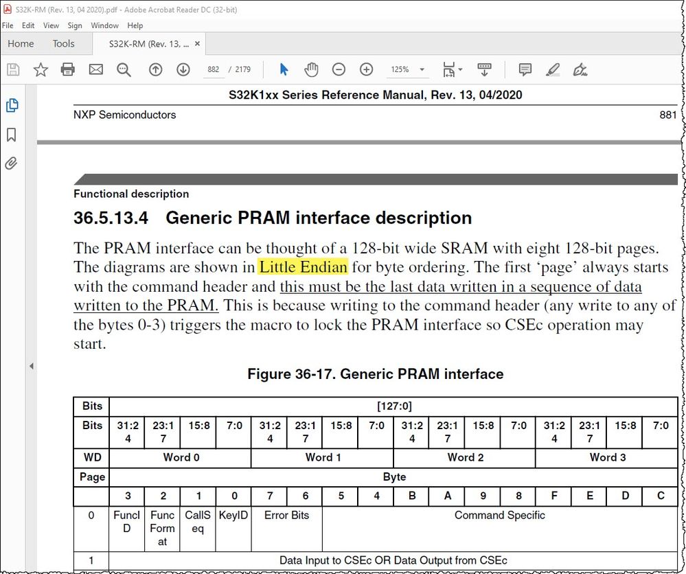

From the description of the screenshot S32k reference manual, S32K uses big-endian alignment, but why the actual test is little-endian alignment

Hi xin tu,
This documentation issue should have been fixed in latest S32K1xx MCU Family - Reference Manual (REV 13).
Here you can see the new description of "36.5.13.4 Generic PRAM interface description":
