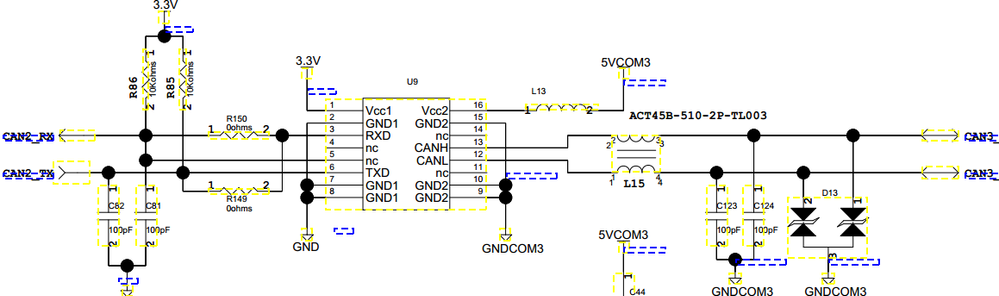

My hardware is:
hello SDK:

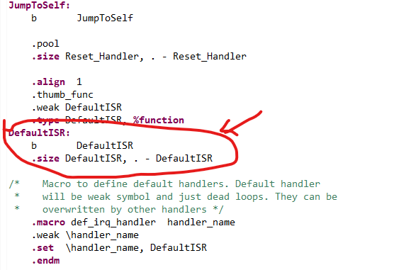

when I use CAN_h\CAN_l frequently, the program always enters "DefaultISR", or CAN receive buffer cannot enter "FLEXCAN_MB_IDLE", which is always busy.Therefore, the original CAN was sent normally, but now CAN CAN no longer restore the original sending state.Can can resume working only through software reset or power-on reset.Why is that?How to solve this problem?

Do you have enabled all the clocks before use the CAN driver, did you that ?
You get default ISR because you probably trigger an exception you need to identify what cause that first ! Try to step in functions to identify exactly at what line is crashing.
