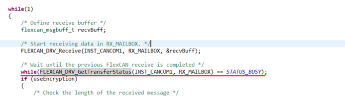

you can use FLEXCAN_DRV_GetTransferStatus to get the status of the currently used MB to determine whether the reception or transmission was successful.
for example:
