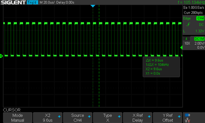

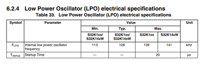

I am attempting to use the LPO clock as the clock source for the watchdog. During development, it became clear that the clock was not running at the expected frequency, as the watchdog would reset prior to the expected time.
From the data sheet ( https://www.nxp.com/docs/en/data-sheet/S32K1xx.pdf ), I expect the LPO to run between 113 - 141 kHz:
To measure the exact speed of the LPO clock, I configured a pin as CLKOUT and selected the LPO128K clock, and attached an oscilloscope to the pin. I measured the frequency at ~105kHz:
I have not made any modification to the LPOTRIM register in the PMC peripheral. When I inspected it with the debugger, I saw a value of 0b00010.

The Low Power Oscillator (LPO) frequency is trimmed to be close to 128kHz during production at room temperature. Each trim step adjusts the frequency by approximately 3kHz, so it cannot be trimmed precisely to 128kHz. The LPO frequency is heavily dependent on operational conditions, and there is no official specification for its characteristics.
The PMC_LPOTRIM register holds the trim value, which is automatically loaded from flash memory IFR after any reset. Please ensure that your software does not clear this value to maintain the trimmed frequency.
This is understandable. I expect a wide variation in part to part LPO frequencies, because of the wide range given in the data sheet.
However, I am running this test using a device sitting on my desk. This should be reasonably close to ambient conditions. A measured output of ~105kHz is many ~3kHz steps away from 128kHz. It seems that the default PMC_LPOTRIM value with my device at or close to room temperature should result in a value much closer to the target frequency of 128kHz, and certainly within the range stated on the data sheet.
How can this be true? The data sheet states the operating range for the LPO frequency. Is the data sheet not an official specification?

Unfortunately, we do not have a detailed correlation between temperature and LPO frequency. Generally, we only share the minimum (113KHz) and maximum (139KHz) values, which include aging and temperature aspects, as our SoC implementation supports LPO trimming.
This statement is what I expect, that the LPO clock frequency should be within the minimum and maximum values stated on the data sheet (though I need to note the maximum value you shared is for the S32K144, while the SoC that I am having trouble with is the S32K144W variant). However, it is not the case. The LPO clock is running below the minimum value, at ~105kHz.
