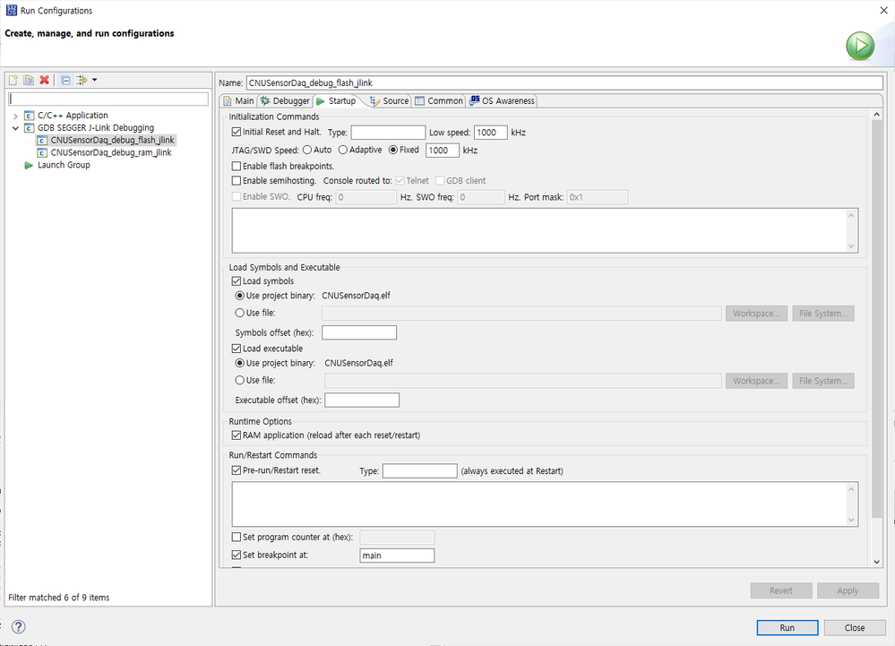

Hello, I am a beginner developer who is new to the nxp s32k144 series.
I am in trouble because of the following errors.
Error in keeps stopping at the starting target cpu and No source available for "0x0"
Please help.

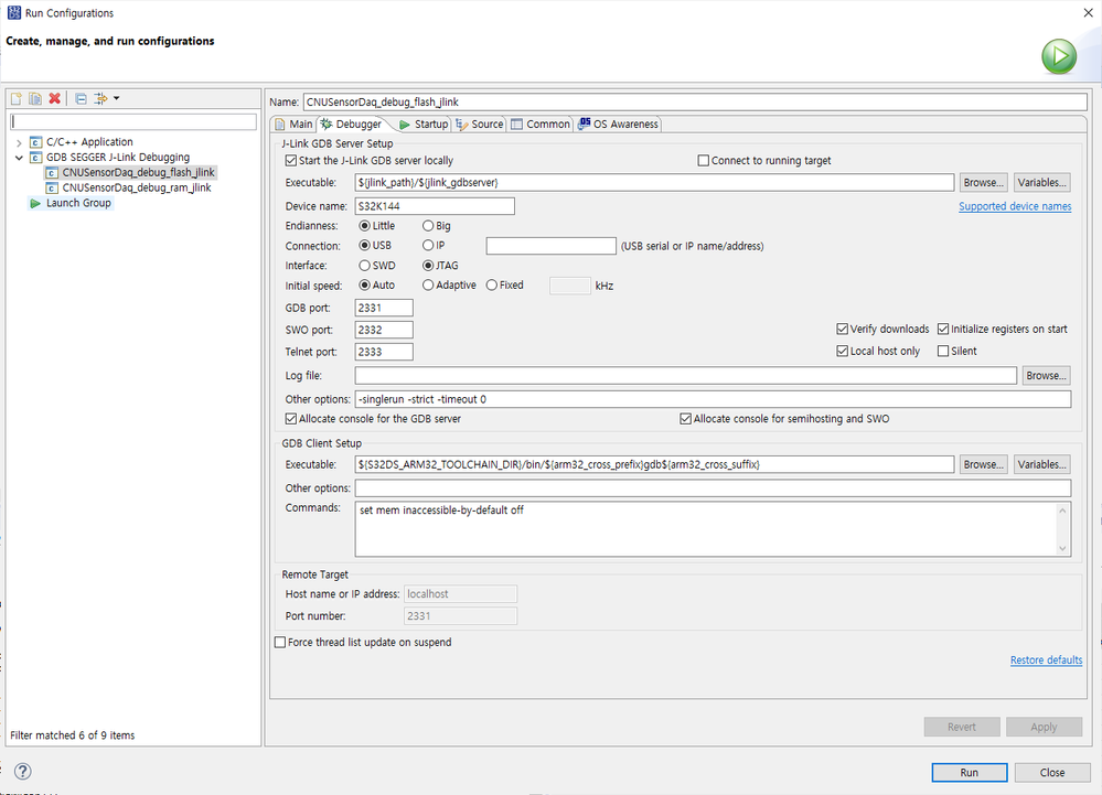

SEGGER J-Link GDB Server V6.42a Command Line Version
JLinkARM.dll V6.42a (DLL compiled Feb 1 2019 18:00:08)
Command line: -if jtag -device S32K144 -endian little -speed auto -port 2331 -swoport 2332 -telnetport 2333 -vd -ir -localhostonly 1 -singlerun -strict -timeout 0

and here is my run configuration

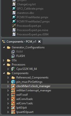

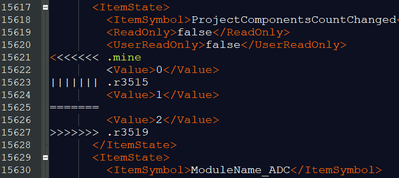

sparkee
Contributor V
It happened again but I figured out what was causing the issue.  Some strange characters were inserted into the PE file.
These coincide with random files that showed up on my system that are older versions of the PE file.  They've been there a while, not sure why this changed happened to the working PE file.
I removed the characters and everything seems to be working again.

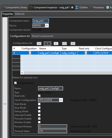

So the issue partially persists.  I'm able to build and program and it doesn't seem to be doing anything negative though.  I get an unsupported number format error when opening the program and loading the project:
Here is the component inspector for wdg_pal1:
It's not happy about the Percent Window value being 0 despite the mouse-over telling me the number can be 0-100.  If I check the Window Enable box, I can change the value to 100 and the issue goes away but if I uncheck the Window Enable box it changes the number to 0 and the error shows back up.  Should I just ignore this?

danielmartynek
Hi Dylan,
An update from the IDE SW team:
"This bug will not effect to any operation of the driver and generate files. Its just make S32DS show a message in Console window: Could not set item value - unsupported number format....
User can ignore it."
