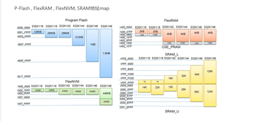

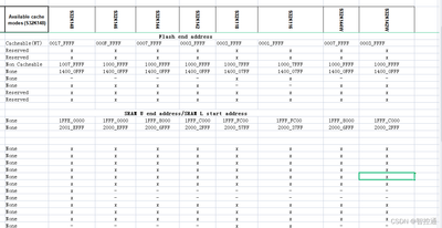

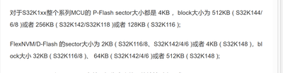

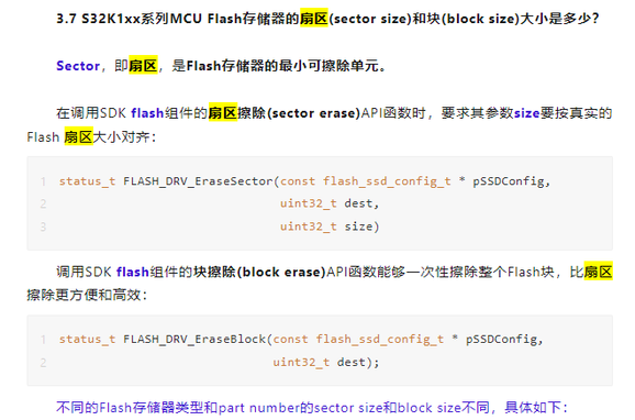

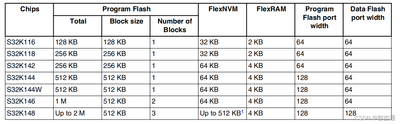

i have read the s32k-RM and s32 sdk api thoroughly,but not found the flash sector information about S32K144,i want to konw how many bytes a scetor contains,

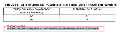

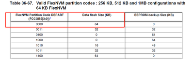

secondly,if i just  need flexnvm  as dflash , what else shoud i need to do  in the function "Flash_Init"?
void Flash_Init(void)
FLASH_DRV_Init(&Flash_InitConfig0,&Flash_SSD_InitConfig0);
if(Flash_SSD_InitConfig0.EEESize == 0)
FLASH_DRV_DEFlashPartition(&Flash_SSD_InitConfig0,0x02,0x04,0,false,true);
FLASH_DRV_SetFlexRamFunction(&Flash_SSD_InitConfig0,EEE_ENABLE,0,NULL);
i have read the api ,but i still fell confused,thank you

Hi@zq1
all you question can be solved on this article.

2.if i just  need flexnvm  as dflash,
a.EEPROM DATA SIZE = 0 -----------------------------------> FCCOB4[3:0] = 0xf
b.Data Flash Size = 64 kbytes (for S32K14x)------------->FCCOB5[3:0] = 0x0
FLASH_DRV_DEFlashPartition(&Flash_SSD_InitConfig0,0xF,0x00,0,false,false);

Senlent
Hi@zq1
S32 SDK -> FTFC
1.
3,820 Views
zq1
thank you very much ,your reply is very useful to me ,according to your reply ,i have find some information in s32-RM,here i put them intend to review More conveniently

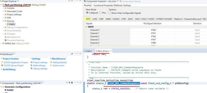

 first ,the flash driver must copy to ram and run in the ram,how coud i do to get it? is there  a special function to make it ?

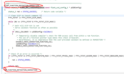

Senlent
Hi@zq1
if you're using SDK to create your project then you don't have to do that,
for example, you can see this function was already mapped to RAM.
3,803 Views
zq1
the instructions you  came out with a red coil ,i can not find them in my project with sdk,could you please copy it and paste here,i want learn how to ue se it and figure out the theory

zq1
i must say :thank you very much ,but i still have questions :
i have found the macro: START_FUNCTION_DEFINITION_RAMSECTION,this means if i want to use the fuction and make it runing in the ram ,i have to add START_FUNCTION_DEFINITION_RAMSECTION and  END_FUNCTION_DEFINITION_RAMSECTION while define the function?
or just need do as :https://community.nxp.com/t5/S32K-Knowledge-Base/S32K-How-to-make-Flash-Driver-image/ta-p/1630873
3,762 Views

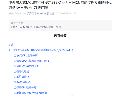

Senlent
Hi@zq1
"i have found the macro: START_FUNCTION_DEFINITION_RAMSECTION,this means if i want to use the fuction and make it runing in the ram ,i have to add START_FUNCTION_DEFINITION_RAMSECTION and  END_FUNCTION_DEFINITION_RAMSECTION while define the function?"
The above is only designed for flash, if you want to map some functions to RAM, you have to do some steps, just like the steps of making flash driver.
this article is very detailed.
https://mp.weixin.qq.com/s?__biz=MzI0MDk0ODcxMw==&mid=2247484996&idx=1&sn=1d18b1781a491406524fc230b8...
