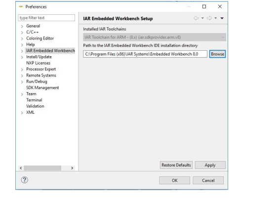

I develope the s32k144 project with IAR. But I need the S32K144 start.s for iar.So where Ican find it.

Please find the WeChat Public Account paper as below link:
S32DS for ARM v2018.R1安装IAR Eclipse插件调用IAR工具链开发S32K系列MCU应用程序详解
I also attached the demo project for your reference.

我的S32DS版本是 S32DS_ARM_Win32_v2018.R1_b180326,IAR版本为8.32.2(非正版)

I refer to this spec step by step.But I could ot find below step.

after install the IAR-Plugin, you need to close and re-open the S32DS IDE or switch to another new workspace to make the IAR-plugin working.
