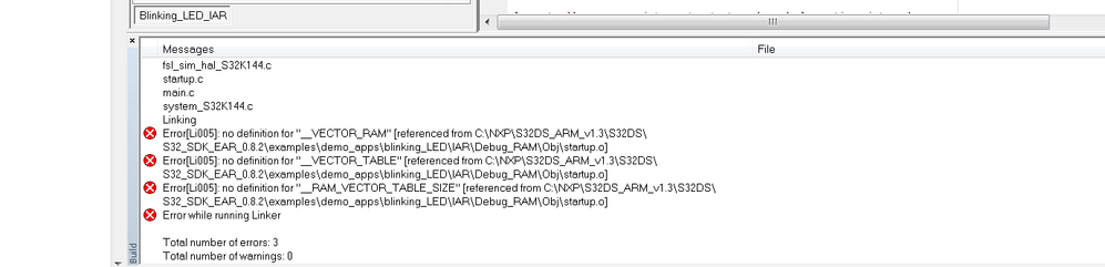

I am trying to run "blinking_LED" demo app in S32DS SDK. I have imported the project in IAR Embedded Workbench IDE. when I try to build all I get error about missing symbols that i see are defined in linker file.
I see these symbols are already defined startup code file "startup_S32K144.s". This file is compiled successfully still it issues in linker. can anyone please check what is it that I am missing.
Quick help in this would be highly appreciated.

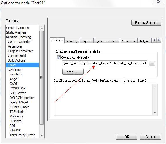

cheney
Pls check project option ->Linker->Config:option.JPG

cheney
You should change the IAR's default linker file to S32K144_64_flash.icf or S32K144_64_ram.icf.

muhammadimranaf
Hi ,
Thanks for the reply. I have already tried with this change. But no success.
2,613 Views
cheney
Pls check the linker file whether it includes the following descriptions.
define exported symbol __VECTOR_TABLE          = m_interrupts_start;
define exported symbol __VECTOR_RAM            = isdefinedsymbol(__flash_vector_table__) ? m_interrupts_start : m_interrupts_ram_start;
define exported symbol __RAM_VECTOR_TABLE_SIZE = __ram_vector_table_size__;
