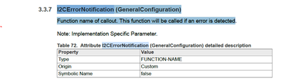

For error cases, I think you should enable error notification and add I2c_StartListening() in this function:
1,412件の閲覧回数
TysonHu
I agree with you about the handle of the error cases and that's what I have done.  However, the interface of error notification will only be called while FIFO error or Bit error occurs for slave mode.

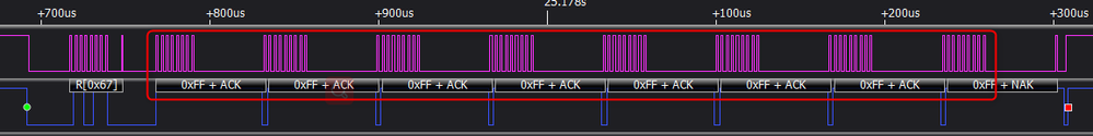

In my case, I2C master intends to read data from slaver(S32K144 MCU). On the I2C bus, it's observed slave address and ACK bit are transmits correctly. But all the data  transmitted on the bus are 0xFF, which are not sent  by MCU. This is similar to the description:
https://www.i2c-bus.org/i2c-primer/analysing-obscure-problems/data-bytes-from-slave-are-0xff/

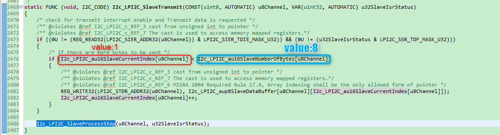

After this Read action, I2C master regards the transmission of this time has been finished. But the slaver still regards it not finished.  It can be observed I2c_LPI2C_au16SlaveCurrentIndex is still less than I2c_LPI2C_au16SlaveNumberOfBytes.

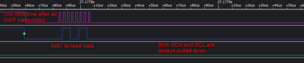

On the next time, the I2C master tries to write data to the slaver, the SDA and SCL are pulled down all the time. An I2C slaver interrupt is always triggered, function I2C_LPI2C_SlaveTransmit() also is always called whatever TDF is not set.  MCU falls into the trap of endless I2C slaver interrupt. Normal tasks cannot be executed any more.
I analyzed this is caused by the slaver is out of step with master. It is to be optimized to handle the mismatch of interrupt flags and the function pointer of I2c_LPI2C_pfSlaveStateOperation  in MCAL.
