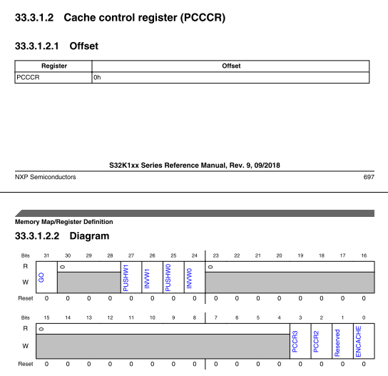

lukaszadrapa
Hi Liu,
1. Yes, but it's very simple one holding just one flash line.
2. Search for Cache control register PCCCR in the reference manual for more details:
And then write this value to the register (from reference manual, page 711):
3. You need to use:
__attribute__ ((section(".code_ram")))
Lukas
