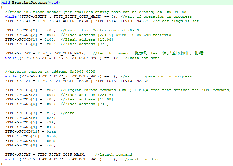

hi,when i erase flash ,the s32k144 reset,the code like that:
close all intertupts:
the "EraseAndProgram" as so as that:
can you help me to solve this promble,thanks!
