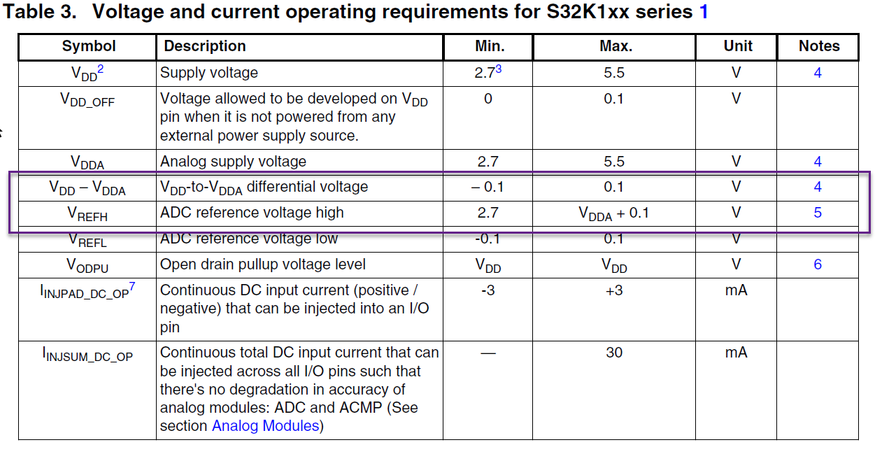

VREFH has the following three options,what's the difference between these three terms?
Whether the function safety level B ia affected?

Hi @jingfang,
These are just a few options that the EVB allows.
1. VDD_MCU is connected to VDDA. Therefore, VREF = VDDA.
2. If VDD_MCU is 5V, VREFH can be 3V.
3. You can use whatever voltage reference connected to AREF.
This specification must be met:
Regarding function safety, please refer to the S32K1xx Safety Reference Manual that is available in SafeAssure NDA community group:
https://community.nxp.com/groups/safeassure-nda
I you don't have access, please follow this document:
https://community.nxp.com/docs/DOC-335524
