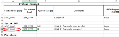

Hi NXP team,
We are currently using S32K144 and have encountered a problem. Could you please help us solve it? Thanks!
From S32K1xx_Memory_Map.xlsx of the RM, the start address of SRAM_U is 0x2000_0000:
Could m_data_2‘s ORIGIN in the link file S32K144_64_flash.ld of S32K144 be set arbitrarily? For example, can it be changed to be less than 0x2000_0000 as following?
BTW, we made an initial attempt(change m_data_2‘s ORIGIN to 0x1FFFE000) and confirmed that the compilation could be successfully passed in the S32DS environment, and the generated program could be smoothly downloaded to the S32K144 product board with a normal running status.

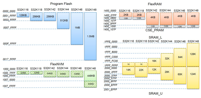

Senlent
Hi@AlexKlose
The reason why we define it this way is based on the physical address space of the two blocks of SRAM, which is more reasonable, but you will not get an error if you define it this way.
For s32k144,
the SRAM_L  address range is :0x1FFF8000~0x1FFFFFFF
the SRAM_U address range is: 0x20000000~0x20006FFF
0x1FFFE000 is in the range SRAM_L, but it is not SRAM_U.

Senlent
Hi@AlexKlose
Usually users may not pay attention to the fact that SRAM_L and SRAM_U are two different blocks.
This needs to be noted when dealing with certain issues, such as ECC processing.
