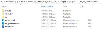

I have a question regarding the usage of LinIf plugin from the RTD in Tresos.
When trying to add LinIf module in Tresos it returns the following error:
Module "LinIf_TS_T40D2M30I0R0" (defined in plugin "LinIf_TS_T40D2M30I0R0") defines the schema file "config/LinIf.xdm" which cannot be found (if the file is signed or crypted, it must be referenced in META-INF\CRYPTOMANIFEST.MF).
Unlike other modules, LinIf folder does not have a config folder where LinIf.xdm should have been
Is ths a wrong installation or should the LinIf.xdm be generated separately somehow?
There is no LinIf.xdm in older RTD installations either.
Thanks!
1,120件の閲覧回数
Julián_AragónM
Hi @nbgddddd,
Please refer to the release notes for the RTD release (Version 3.0.0). You can see in the "Support and Delivered drivers" section, the LinIf driver delivered with the RTD is only a stub, it does not support configuration.
This is only for testing purpose from our side. You should use CanIf, EthIf & LinIf from a third-party provider, such as Elektrobit (EB), Vector, etc.
