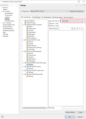

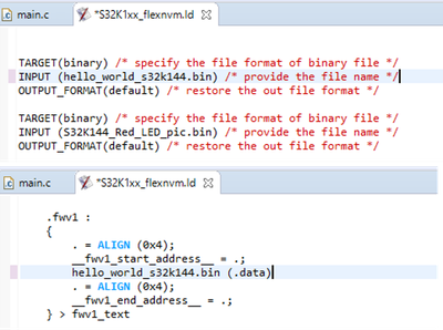

1. I created the binary file by referring to the documentation I received. At this time, I set the 'Output file format' to 'Raw binary' (first figure).
2. The created binary file was moved to the same location as 'S32K144_Blue_LED_pic.bin' in the S32K144_FOTA_Gateway folder (second figure).

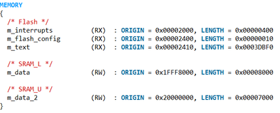

3. Replaced 'S32K144_Blue_LED_pic.bin' with 'hello_world_s32k144.bin' in two places in the source code of 'S32K1xx_flexnvm.ld' of S32K144_FOTA_Gateway (third figure).
4. When I ran the demo, I was able to update the firmware for the red LED, but not hello_world.
Can you see where I am going wrong?

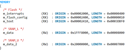

did you updated linker file of the hello world application? It should be like:
This is to compile "position dependent" code to Firmware 1 slot:
For second slot, you should use base address 0x00042000.
Lukas

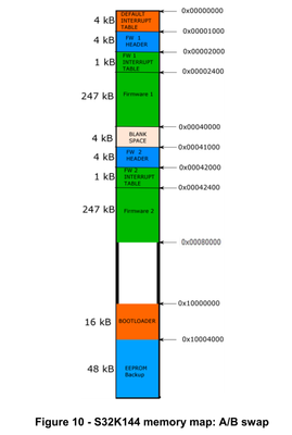

I forgot to mention one more thing - S32 Design Studio does not support generation of position independent project. So, if you compiled your hello world project in S32DS, you need to track the firmware versions to load new version to the right space. In other words, you need to know if hello world project will be loaded to address 0x2000 or to 0x42000. The project needs to be compiled to the right address, so it may be necessary to update the linker file. I guess that this could be the reason.
More description can be found in the application note in section "6.3 A/B swap using Position Independent Code (PIC) ". As mentioned, IAR compiler supports PIC code.

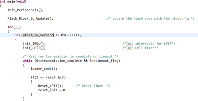

However, when I try it on another microcontroller, the latest_fw_version=xFFFFFFFF in the main.c of the bootloader, and it does not work. I think this is due to the fact that the firmware header has not been created.
I thought that if I debug the firmware linker file as shown in the image, the FW1 header will be created, is that wrong?
How can I solve this problem?

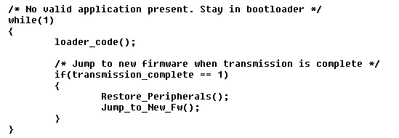

lukaszadrapa

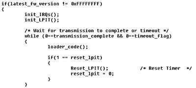

the FW header is updated after successful download of new application.
If you have bootloader programmed only (no application yet) then the bootloader stays in this endless loop waiting for transmission_complete (it's set once new application is loaded). After that, FW headers are updated in loader_code() function and it will jump to the new application:
If there already is an application (or applications), it waits for timeout to start the application or it downloads new application from gateway - there's exactly the same code waiting for transmission_complete and it updates the headers after that.
If the header was not updated then the application obviously was not downloaded. Or it was downloaded only partially. Therefore I would check the content of flash - if whole application is present.
