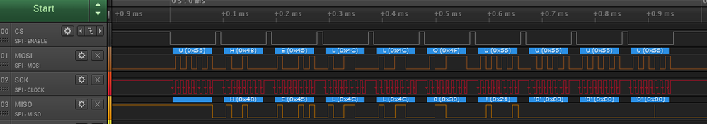

I'm using spi_pal demo from SDK S32DS_ARM_v2018.R1.
The master is configured to use FLEXIO SPI.
I have a question related to the CS pin. As you can see on the picture below, the CS is disabled between every bytes.
Is there a way to enable the CS pin as long as the master has data to transmit?

This feature is not available in Flexio, but you can use it on LPSPI. Please switch to LPSPI and select continuous mode.
In this mode CS is assert for all frames which are configured in your sending function.
I don't get exactly what are you trying to do with with the next SPI. Why both of them are masters?
If PTB0 is routed to Flexio you can't use it as GPIO.

Yes by changing the master from Flexio to LPSPI we were able to use the continuous mode.
thank you.
