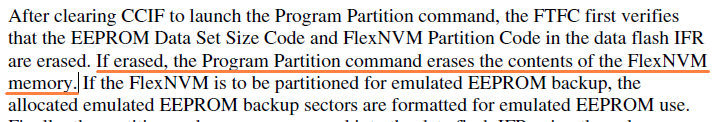

  • Then it starts with the partitioning phase. As it is written in AN11983:
Before launching the program partition command the FlexNVM and D-flash IFR must be in an erased state. It is recommended that a new device is partitioned as the first step in factory programming.
Here, I've a question about the terminology used. As I understand from AN11983, the s32k1xx devices have the P-Flash memory and the FlexNVM memory. The FlexNVM memory can be configured as D-Flash, E-Flash or a combiantion of both. So, when the document says "FlexNVM and D-Flash IFR must be in an erased state", do you need to erase only the FlexNVM memory? (2) (IFR = nonvolatile Information Register found in each flash block, separate from the main memory array)
  • Turning back to the code example, it erases both P-Flash and FlexNVM memories. It can do that because the code is charged directly in RAM, but this is impossible for me since my code should be stored on the Flash memory, thus I can't erase the P-Flash memory. What I have to do in order to erase only the FlexNVM memory? When I place the code directly in Flash, is FlexNVM automatically erased? (3).

2.
D-Flash IFR has to be erased. The Program Partition command erases the contents of the FlexNVM memory (Section 36.5.11.14 RM rev.7).
3.
Just place the function that launches the Program Partition command into RAM and wait there until the command is complete.
