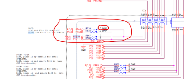

Reference your documents:
The pin of [J2-19] and [J2-17] is defined for signal [PTE10]&[
PTA3] , and [PTE11]&[PTA2] at the same time.
Now, I have to use [PTA2], [PTA3], [PTE10] and [PTE11] ports at the same time.
How do I know the signal of [J2-19] pin is the [PTE10] or [PTA3] ?
and is the signal of [J2-17] pin the [PTE11] or [PTA2] ?

Hi@CY9
You need to look at the schematic diagram to understand everything.
“DNP”->Do Not Populate
