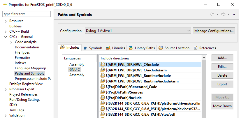

I'm working with the S32K144 evaluation board But I'm having some errors using UART in FreeRTOS I got source FreeRTOS_printf_SDKv0_8_6 and In S32DS ARM R1 compiled but fatal error: No such file or directory (ewl_misra_types.h and file_struc.h )
Does anyone have it?

seems you are pointing to example posted here EXAMPLE: S32k144 UART printf/scanf under FreeRTOS - S32DS
I have downloaded it and imported it to the S32 DS ARM 2018.R1. I see no issue with compiling, I got no errors.
ewl_misra_types.h and file_struc.h files should be located in below directories within DS installation
..\S32DS_ARM_v2018.R1\S32DS\arm_ewl2\EWL_C\include\
..\S32DS_ARM_v2018.R1\S32DS\arm32_ewl2\EWL_C\include\
check those directories and be sure one is listed in project's path
BR, Petr

Hi thanks
It works

Hi thanks
It works
