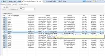

I tried 'External interrupt' using s32K144 EVB.
Using example 'hello_world_s32k144', modified button1 ,2 interrupt example.
Please refer below comment in 'main.c' file.
/* Kevin START */
/* Kevin END */

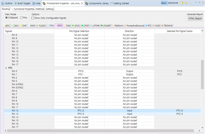

1.  changed PIN 12, PIN 13 by input setting like below.
2. changed  PTC 12,PTC 13 interrupt option

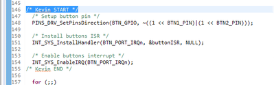

4. Modified 'main.c' file
   /* Kevin START */    ~my changed code ~  /* Kevin END */
