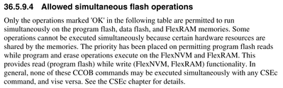

Problem: When using S32K144 to generate MAC value calculation, while waiting for the execution of the CSEc command CMD_GENERATE_MAC, the P-Flash is accessed asynchronously, and the result is reset, as follows:
long int index;
unsigned int *add = (unsigned int *)0x0;
void CSEC_WriteCmdAndWait(csec_cmd_t funcId,
csec_func_format_t funcFormat,
csec_call_sequence_t callSeq,
csec_key_id_t keyId)
char i;
CSE_PRAM->RAMn[0].DATA_32 =
CSE_PRAM_RAMn_DATA_32_BYTE_0(funcId) |
CSE_PRAM_RAMn_DATA_32_BYTE_1(funcFormat) |
CSE_PRAM_RAMn_DATA_32_BYTE_2(callSeq) |
CSE_PRAM_RAMn_DATA_32_BYTE_3(keyId);
while ((FTFC->FSTAT & FTFC_FSTAT_CCIF_MASK) == 0U)
/* Wait until the CCIF flag is set */
for (index = 0; index < 10 *1024; index++)
i = add[index];
It is ok to wait for the command execution to complete in while, but reset occurs when accessing data on p-flash

not sure if I can understand the description. Do you run some flash operation or do you only read the pflash?

reading the p-flash in running csec operation of generate mac at the same time.

I can't see a reason for that. Moreover, when using CSEC_DRV_GenerateMAC function, CSEc does not access the flash directly. This function just copies required data to CSE PRAM memory and then CSEc calculates MAC over this data. The CSEc reads the flash directly only when using CSEC_DRV_GenerateMACAddrMode.
So, it seems to be just a side effect of something else. What can you see in RCM_SRS register after such reset?
