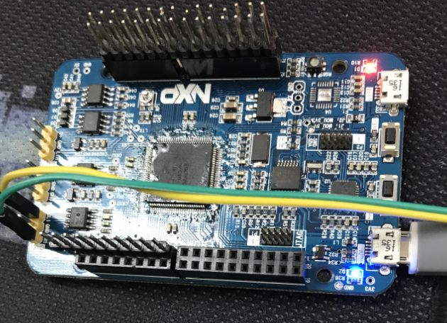

I have a promble about s32k144's flexcan,it is the can's receiving,it's send is ok,but can't receive data,the code like that:

I call the function like that :
uint8_t can_test[8]={0x01,0x02,0x03,0x04,0x05,0x06,0x07,0x08};
Can_Send(0x1806e5f4,&can_test[0],8);
FLEXCAN0_receive_msg();
the results like that:
can you help me solve the promble,thanks for your help! i don‘t know if it is the mailbox is not activated。
the EVB like that:
