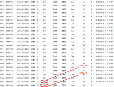

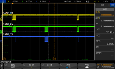

I use one S32K144 EVB's CAN0 and CAN1 to complete CAN's Tx and Rx. The code is based Demo_CAN_S32K144 project. CAN0 send a 8 bytes frame to CAN1, CAN1 receive the frame and verify if this frame is desired packet. If yes, change CAN-ID and send same frame to CAN0. When CAN0 receiver CAN1's reply frame, verify to see if it is the desired frame. If yes, CAN0 send next frame to CAN1, CAN1 receive the frame and verify it......
At first, the code process soomthly. But CAN0/CAN1 tx/rx run about send 5000+ frame, the CAN0 send a frame without a data content. The communication procedure stop. The can device USBCANFD show the last frame is a remote frame, but I don't send remote frame in code. I don't know it is a remote frame or a false frame without frame content.  I attach the last data's waveform and USBCAN device's data log. Thanks.

Thank you. My version is S32DS for ARM 2.2. Just now I found the root cause and resolve method in website. The Rx_buffCfg/Tx_buffCfg structure can't be set as a local variable in CAN0_Init()/CAN1_Init(), they should be set as gloabl variable. For detail, please find chapter 3.3 in the link https://blog.csdn.net/tao475824827/article/details/106757092

I runn the code and find in CAN0_Callback_Func()/CAN1_Callback_Func() functions,  the CAN_Receive() always return STATUS_BUSY, not STATUS_SUCCESS. Maybe that's the root cause. But I don't know why this condition happens, can anyone give me some explaination? Thanks.
