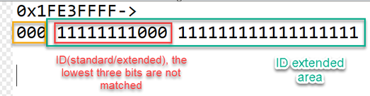

Hi@AnilKumar409
modified base on the demo of S32K144_Project_FlexCan
MB1 used for receiving messages which id range of 0x100~0x107,
(in this case,0x108 need to be allocated a MB for it separately)

  CAN0->RAMn[ 1*MSG_BUF_SIZE + 1] = 0x100 << 18;//Standard ID = 0x100
  //receive range of standard IDs of 0x100~0x107
  CAN0->RXIMR[1] = 0x1FE3FFFF;

I have gone through your demo code. Can you make brief about this line,
I was not able to understand how it got defined.

Senlent
Hi@AnilKumar409
