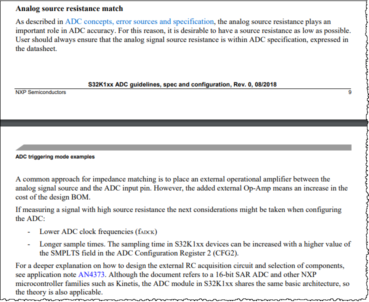

Dear Team,
I am having an accuracy problem reading the voltage value using the adc of the s32k144, so I have a question.
I used an op amp on the front to read a voltage of around 240.31mV.
Two points were measured with a multimeter.
1. When I measured pin 1 of the opamp side, I read 240.31mV voltage.
2. When I measured ADC0 13 on pin 45 of s32k144 MCU, I read 240.31mV voltage.
I read the ADC value using S32DS SDK, but the value is incorrect.
I am attaching a code and picture of setup.
What's wrong?

Hi ldj979, Please check the voltage of VREFH. Make sure the value match the #define ADC_VREFH 5.0f. I did not find any obvious errors in your configuration. Have you try to measure another voltage signal? (RAD<5kΩ) Is the ADC conversion result still inaccurate?
Table 40. 12-bit ADC operating conditions.pngTable 40. 12-bit ADC operating conditions.pngAnalog source resistance match.pngAnalog source resistance match.png

I solved it by attaching a pull-up resistor on the front end. Thank you for answer
