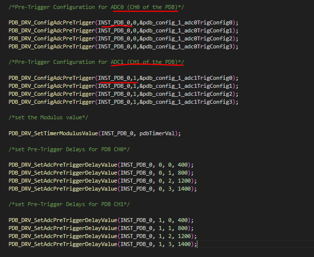

/*Pre-Trigger Configuration for ADC0 (CH0 of the PDB)*/
PDB_DRV_ConfigAdcPreTrigger(INST_PDB_0,0,&pdb_config_1_adc0TrigConfig0);
PDB_DRV_ConfigAdcPreTrigger(INST_PDB_0,0,&pdb_config_1_adc0TrigConfig1);
PDB_DRV_ConfigAdcPreTrigger(INST_PDB_0,0,&pdb_config_1_adc0TrigConfig2);
PDB_DRV_ConfigAdcPreTrigger(INST_PDB_0,0,&pdb_config_1_adc0TrigConfig3);
/*Pre-Trigger Configuration for ADC1 (CH1 of the PDB)*/
PDB_DRV_ConfigAdcPreTrigger(INST_PDB_0,1,&pdb_config_1_adc1TrigConfig0);
PDB_DRV_ConfigAdcPreTrigger(INST_PDB_0,1,&pdb_config_1_adc1TrigConfig1);
PDB_DRV_ConfigAdcPreTrigger(INST_PDB_0,1,&pdb_config_1_adc1TrigConfig2);
PDB_DRV_ConfigAdcPreTrigger(INST_PDB_0,1,&pdb_config_1_adc1TrigConfig3);
/*set the Modulus value*/
PDB_DRV_SetTimerModulusValue(INST_PDB_0, pdbTimerVal);
/*set Pre-Trigger Delays for PDB CH0*/
PDB_DRV_SetAdcPreTriggerDelayValue(INST_PDB_0, 0, 0, 400);
PDB_DRV_SetAdcPreTriggerDelayValue(INST_PDB_0, 0, 1, 800);
PDB_DRV_SetAdcPreTriggerDelayValue(INST_PDB_0, 0, 2, 1200);
PDB_DRV_SetAdcPreTriggerDelayValue(INST_PDB_0, 0, 3, 1400);
/*set Pre-Trigger Delays for PDB CH1*/
PDB_DRV_SetAdcPreTriggerDelayValue(INST_PDB_0, 1, 0, 400);
PDB_DRV_SetAdcPreTriggerDelayValue(INST_PDB_0, 1, 1, 800);
PDB_DRV_SetAdcPreTriggerDelayValue(INST_PDB_0, 1, 2, 1200);
PDB_DRV_SetAdcPreTriggerDelayValue(INST_PDB_0, 1, 3, 1400);

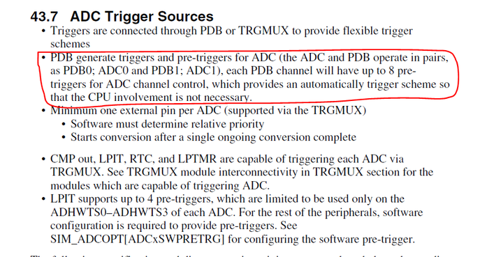

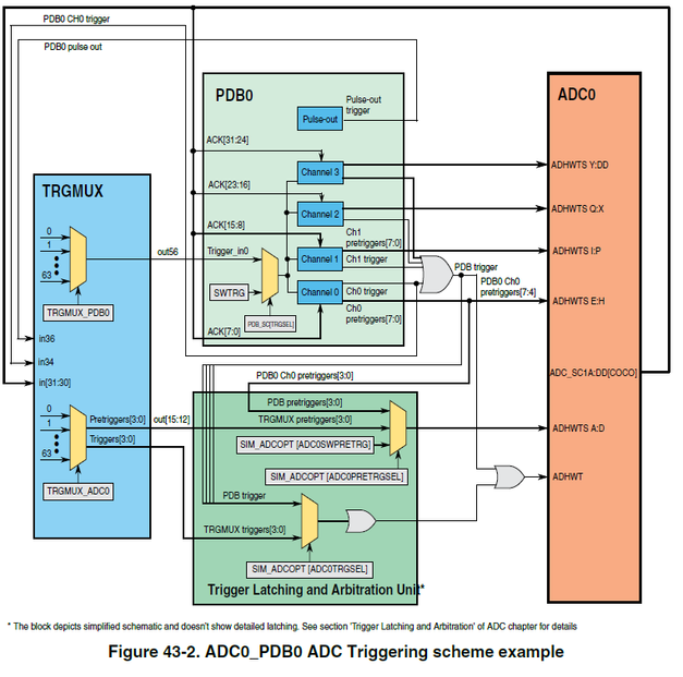

Senlent
Hi@snow3847
But in your code, One PDB instance to trigger two ADC instances.

snow3847
Thank you for the response. Now i understand that PDB0 is for ADC0 and PDB1 is for ADC1 but i have a question : how do i synchronise them? i want the conversion on ADC0 and on ADC1 to start on the same time. if i understood correctly we should use TRGMUX and FTM. if so can you tell me to parametrise TRGMUX (in the pinout section and peripheral section of s32DS) because i barely found documentation on that.
i will attach what i did under my reply.
thank you .
