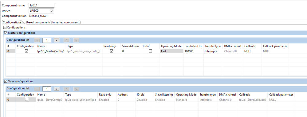

As per our project requirement we configured flex_i2c and lpi2c with FreeRTOS by using S32 Design studio.

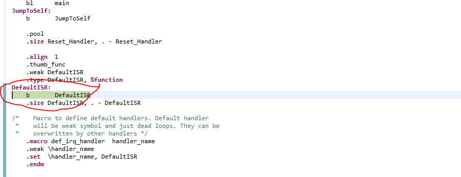

From debugging we got to know once run the LPI2C_DRV_MasterSendDataBlocking(INST_LPI2C1, Data, sizeof(Data), true, 10UL);  function the software will always stuck at at the  DefaultISR: " startup_S32K_.S" file as mentined in below image. The software will not come out from DefaultISR
lpi2c configuration:
FlexIO i2c configuration:

Issue got resolved !!!!!!!
Solution:
When your software integrated with FreeRTOS need to handle the interrupt priority properly. i used following functions  during the i2c initialization  to set the i2c  interrupt.
/* Initialize Interrupt priority for LP I2C driver as bus master */
INT_SYS_SetPriority( LPI2C0_Master_IRQn, configLIBRARY_MAX_SYSCALL_INTERRUPT_PRIORITY );
/* Initialize Interrupt priority for FlexIO I2C driver as bus master */
INT_SYS_SetPriority( FLEXIO_IRQn, configLIBRARY_MAX_SYSCALL_INTERRUPT_PRIORITY );

In S32 Desing studio there is no configuration to set  I2C interrupt priority, Just i enabled interupt configuration.
Please find the attached images for I2C and Os Configuration..
Could you please let me know where i can change the interrupt priority for I2C.
14,841 次查看
razva_tilimpea
In SDK interrupt priority can be changed just by calling INT_SYS_SetPriority in your source code, otherwise the SDK will use default priorities of the hardware.
