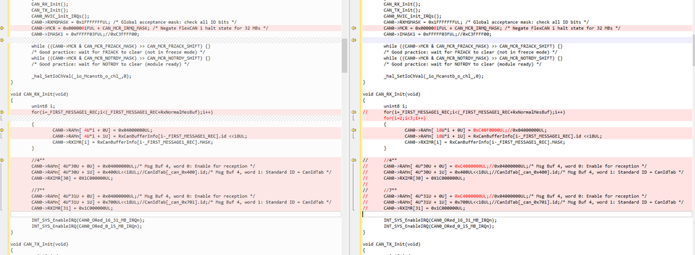

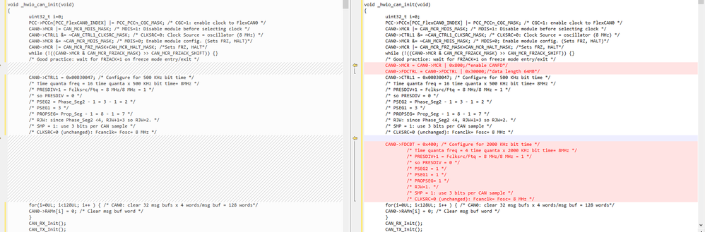

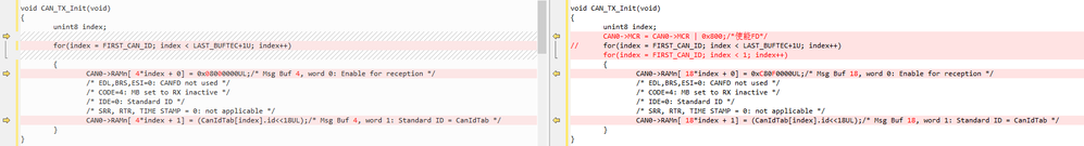

I want to change the can mode to canfd and change the data length to 64 bytes at the same time. It will not work properly after the change as shown in the figure. Please help to check it, thank you.On the left is the can mode that works properly, and on the right is the canfd mode that does not work properly.What's not in the picture is exactly the same.

void _hwio_can_init(void)
	uint32_t i=0;
	PCC->PCCn[PCC_FlexCAN0_INDEX] |= PCC_PCCn_CGC_MASK; /* CGC=1: enable clock to FlexCAN0 */
	CAN0->MCR |= CAN_MCR_MDIS_MASK; /* MDIS=1: Disable module before selecting clock */
	CAN0->CTRL1 &= ~CAN_CTRL1_CLKSRC_MASK; /* CLKsrc=0: Clock Source = oscillator (8 MHz) */
	CAN0->MCR &= ~CAN_MCR_MDIS_MASK; /* MDIS=0; Enable module config. (Sets FRZ, HALT)*/
	CAN0->MCR |= CAN_MCR_FRZ_MASK+CAN_MCR_HALT_MASK; /*Sets FRZ, HALT*/
	while (!((CAN0->MCR & CAN_MCR_FRZACK_MASK) >> CAN_MCR_FRZACK_SHIFT)) {}
	/* Good practice: wait for FRZACK=1 on freeze mode entry/exit */
	CAN0->MCR = CAN0->MCR | 0x800;/*enable CANFD*/
	CAN0->FDCTRL = CAN0->FDCTRL | 0x30000;/*data length 64MB*/
	CAN0->CTRL1 = 0x00B30047; /* Configure for 500 KHz bit time */
	/* Time quanta freq = 16 time quanta x 500 KHz bit time= 8MHz */
	/* PRESDIV+1 = Fclksrc/Ftq = 8 MHz/8 MHz = 1 */
	/* so PRESDIV = 0 */
	/* PSEG2 = Phase_Seg2 - 1 = 3 - 1 = 2 */
	/* PSEG1 = 3 */
	/* PROPSEG= Prop_Seg - 1 = 8 - 1 = 7 */
	/* RJW: since Phase_Seg2 <4, RJW+1=3 so RJW=2. */
	/* SMP = 1: use 3 bits per CAN sample */
	/* CLKsrc=0 (unchanged): Fcanclk= Fosc= 8 MHz */
	CAN0->FDCBT = 0x400; /* Configure for 2000 KHz bit time */
		/* Time quanta freq = 4 time quanta x 2000 KHz bit time= 8MHz */
		/* PSEG2 = 1 */
		/* PSEG1 = 1 */
		/* PROPSEG= 1 */
		/* RJW=1. */
	for(i=0UL; i<128UL; i++ ) { /* CAN0: clear 32 msg bufs x 4 words/msg buf = 128 words*/
	CAN0->RAMn[i] = 0; /* Clear msg buf word */
	CAN_RX_Init();
	CAN_TX_Init();
	CAN0_NVIC_init_IRQs();
	CAN0->RXMGMASK = 0x1FFFFFFFUL; /* Global acceptance mask: check all ID bits */
	CAN0->MCR = 0x0000081FUL + CAN_MCR_IRMQ_MASK; /* Negate FlexCAN 1 halt state for 32 MBs */
	CAN0->IMASK1 = 0xFFFFF03FUL;//0xC3FFFF00;
	while ((CAN0->MCR & CAN_MCR_FRZACK_MASK) >> CAN_MCR_FRZACK_SHIFT) {}
	/* Good practice: wait for FRZACK to clear (not in freeze mode) */
	while ((CAN0->MCR & CAN_MCR_NOTRDY_MASK) >> CAN_MCR_NOTRDY_SHIFT) {}
	/* Good practice: wait for NOTRDY to clear (module ready) */
	_hal_SetIoChVal(_io_Mcanstb_o_chl_,0);
void CAN_RX_Init(void)
	unint8 i;
//	for(i=_FIRST_MESSAGE1_REC;i<(_FIRST_MESSAGE1_REC+RxNormalMesBuf);i++)
	for(i=2;i<3;i++)
		CAN0->RAMn[ 18U*i + 0U] = 0xC40F0000UL;//0x04000000UL;
		CAN0->RAMn[ 18U*i + 1U] = RxCanBufferInfo[i-_FIRST_MESSAGE1_REC].id <<18UL;
		CAN0->RXIMR[i] = RxCanBufferInfo[i-_FIRST_MESSAGE1_REC].MASK;
//	//4**
//	CAN0->RAMn[ 4U*30U + 0U] = 0xC4000000UL;//0x04000000UL;/* Msg Buf 4, word 0: Enable for reception */
//	CAN0->RAMn[ 4U*30U + 1U] = 0x400UL<<18UL;//CanIdTab[_can_0x400].id;/* Msg Buf 4, word 1: Standard ID = CanIdTab */
//	CAN0->RXIMR[30] = 0X1C000000UL;
//	//7**
//	CAN0->RAMn[ 4U*31U + 0U] = 0xC4000000UL;//0x04000000UL;/* Msg Buf 4, word 0: Enable for reception */
//	CAN0->RAMn[ 4U*31U + 1U] = 0x700UL<<18UL;//CanIdTab[_can_0x701].id;/* Msg Buf 4, word 1: Standard ID = CanIdTab */
//	CAN0->RXIMR[31] = 0x1C000000UL;
	INT_SYS_EnableIRQ(CAN0_ORed_16_31_MB_IRQn);
	INT_SYS_EnableIRQ(CAN0_ORed_0_15_MB_IRQn);
void CAN_TX_Init(void)
	unint8 index;
	CAN0->MCR = CAN0->MCR | 0x800;/*FD*/
//	for(index = FIRST_CAN_ID; index < LAST_BUFTEC+1U; index++)
	for(index = FIRST_CAN_ID; index < 1; index++)
		CAN0->RAMn[ 18*index + 0] = 0xC80F0000UL;/* Msg Buf 18, word 0: Enable for reception */
		/* EDL,BRS,ESI=0: CANFD not used */
		/* CODE=4: MB set to RX inactive */
		/* IDE=0: Standard ID */
		/* SRR, RTR, TIME STAMP = 0: not applicable */
		CAN0->RAMn[ 18*index + 1] = (CanIdTab[index].id<<18UL);/* Msg Buf 18, word 1: Standard ID = CanIdTab */
I put the CANFD code here
