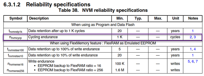

I have set the interrupt disable, and I am currently suspecting that the possible reason is excessive erase-write cycles on a Sector of the PFLASH. What is the minimum endurance count for erase-write operations on PFLASH?
1,763 Views
danielmartynek
Hello @1069466534,
The min. endurance is 1000 cycles.

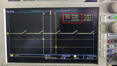

1069466534
When a faulty component undergoes a full erase process through a PE burner, the chip becomes locked and cannot be unlocked. Through inspection of the strategy reset pin, it is found that the reset pin periodically pulls low for 118 microseconds. Based on the above, can you provide possible reasons?
