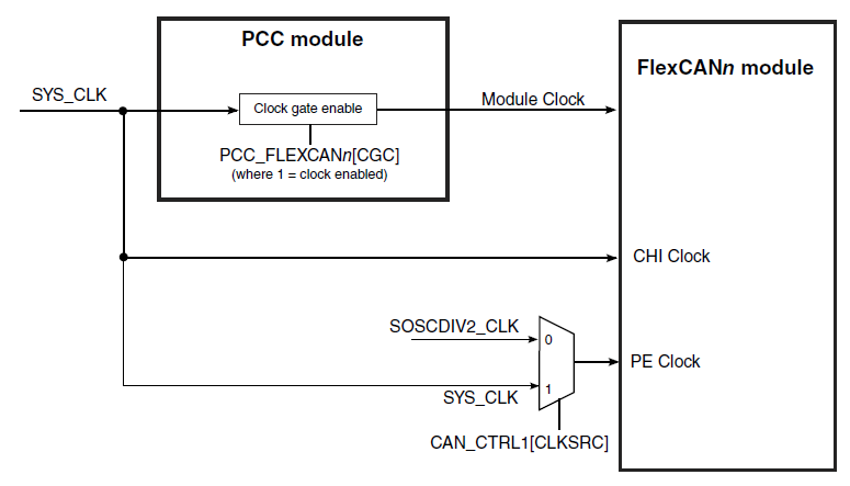

I have a custom board with S32K142 and I did not put an external oscillator on it because it doesn't have space on it. According to this diagram in the reference manual, it is possible to run the FlexCAN module without SOSC:

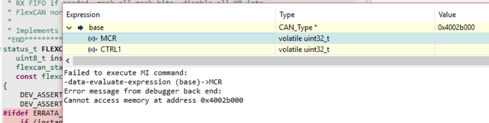

However, when I disable SOSC and try to initialize CAN, it halts at the can initialization step:

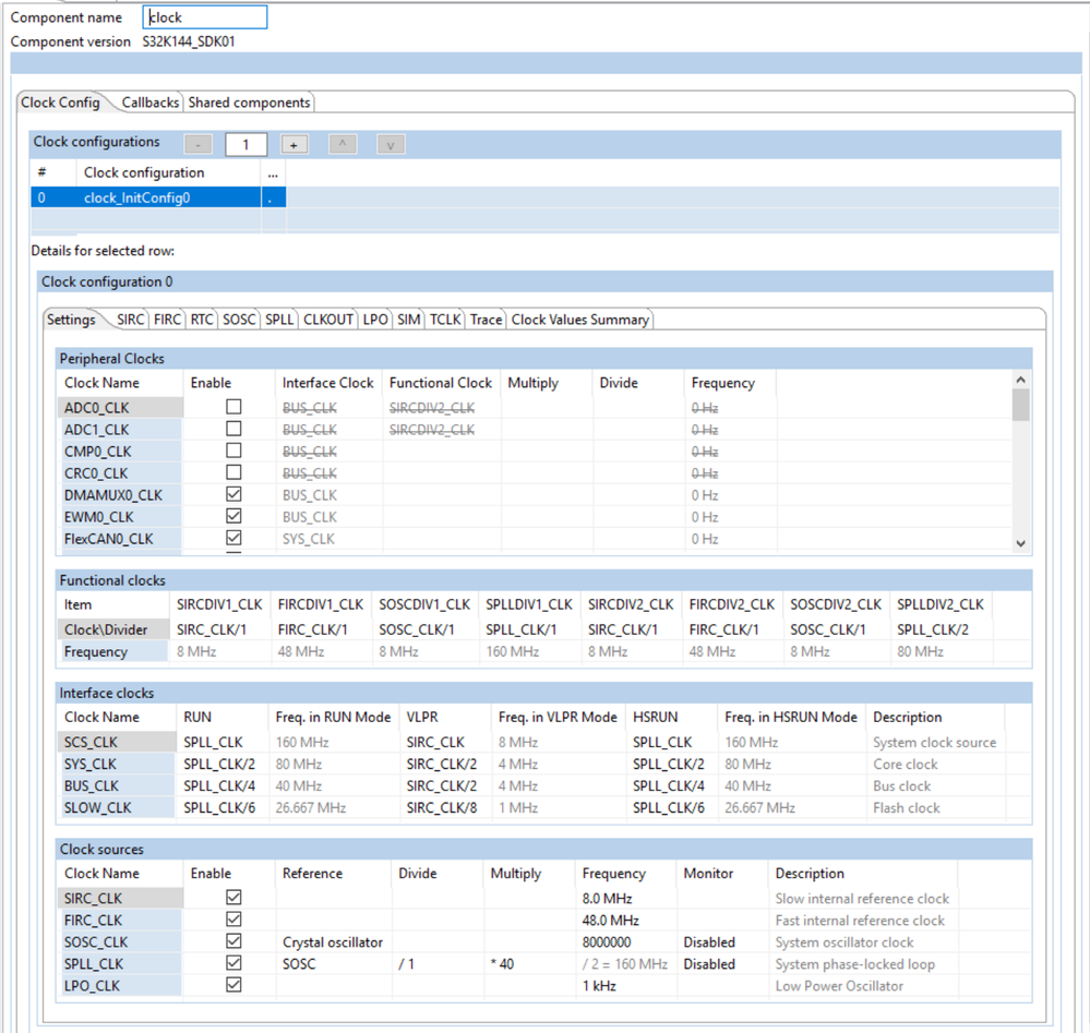

I set the clock source in CAN module to PE clock and it shows that both the module and PE clocks are set to 48 MHz. The clock manager for some reason, shows this:

Yes, all clocks are set but the debugger cannot read the register.
Furthermore, no frequency are specified into the clock configuration panel in PE.
Indeed, it seems like a clock issue.

I have used the sys_clock set to 80Mhz for PE engine too and the flexcan worked as supposed. The PLL it uses as clock source SOSC how did you generate the SYS clock of 80Mhz ?!
11,261 Views
alexandrehochar
I tried with 8MHz and 80Mhz engine clock, it's same.
Link below my clock tree.

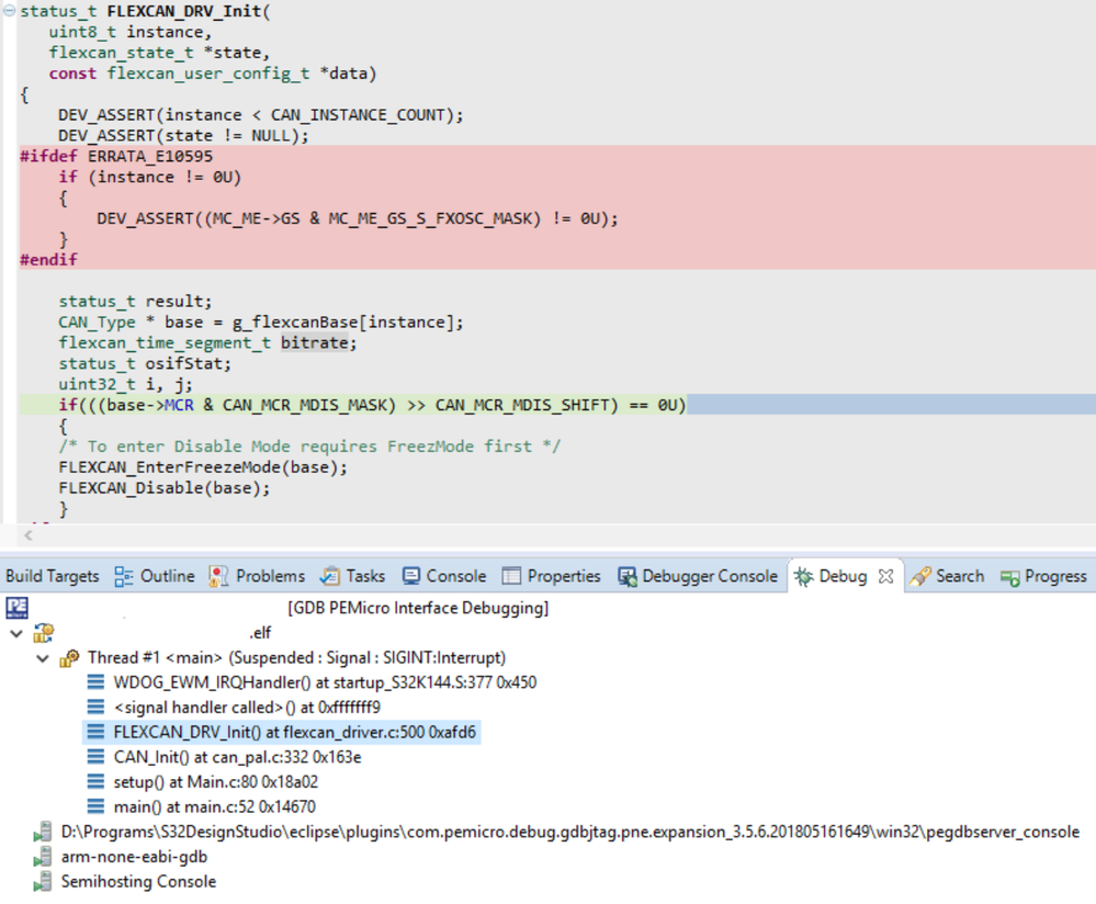

alexandrehochar
I have the same issue. When the driver try to access of MCR register, the code crash.
I tried the fix above but without effet, the code crash when base->MCR is tested.
Someone have an idea why i can't access to CAN registers. The differences with the sample code is that i work with a 80MHz clock source. (But 8MHz Engine clock).

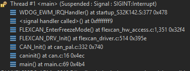

Of course,
Call stack,
And registers,
Thanks a lot for your help.

sripav-7
I looked up the errata code and found this:
This document is intended for MPC574XX controller and I don't think that that register exists in S32K1XX. So I don't think ERRATA_E10595 should actually be defined. I would try deleting those lines of code and see if it works.
