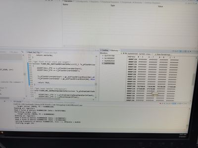

Flash DRV Program () is used to download the corresponding data. When the -128 byte number of data is swiped, only 24 bytes of data are saved in the memory of PFlash. After that, the Program is stuck. When entering the debugging state to view the PFLASH memory, the data that was swiped before was not saved.

can I see input parameters for FLASH_DRV_Program() function when the problem appears? Does it work if you disable interrupts before calling of this function?
