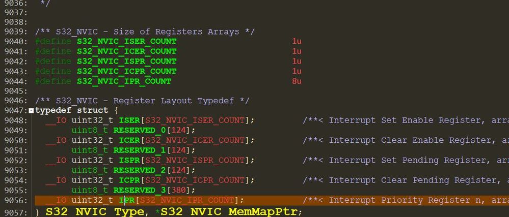

I have to configure for PORTA PIN 2 of s32k116, but it is not wake up through that port pin pressing.

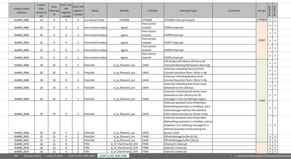

Also in structure for NVIC max allowed index is 8 but in DMA_Interrupt_Mapping excel it mentioned 9.

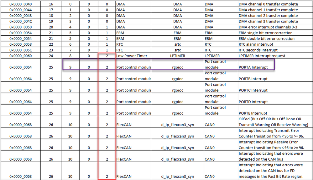

On the S32K11x derivatives, there are single ISER, ICER, ISPR, ICPR registers and eight IPR registers.
To enable the PORTA interrupt, you need to set the 9th bit of the ISER register.
S32_NVIC->ISER[0] |= (1 << 9);‍‍‍

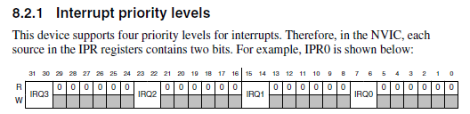

Then, you can set its priority in the IRQ1 bit-field of the IPR2 register.
S32_NVIC->IPR[2] |= S32_NVIC_IPR_PRI_1(0b01000000);  // Priority level 1‍‍
As you can see below, there are only four priority levels.
